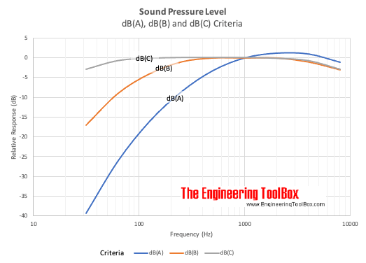

Meer leesvoer:
The human ear is more sensitive to sound in the frequency range 1 kHz to 4 kHz than to sound at very low or high frequencies. Higher sound pressures are therefore acceptable at lower and higher frequencies than in the mid range.
The knowledge about human ear is important in acoustic design and sound measurement. To compensate, sound meters are normally fitted with filters adapting the measured sound response to the human sense of sound. Common filters are
   * dB(A)
   * dB(B)
   * dB(C)
dB(A)
The decibel A filter is widely used. dB(A) roughly corresponds to the inverse of the 40 dB (at 1 kHz) equal-loudness curve for the human ear.
Using the dBA-filter, the sound level meter is less sensitive to very high and very low frequencies. Measurements made with this scale are expressed as dB(A).
dB(B) and dB(C)
The decibel C filter is practically linear over several octaves and is suitable for subjective measurements at very high sound pressure levels. The decibel B filter is between C and A. The B and C filters are seldom used.
Comparing dB(A), dB(B) and dB(C)
The decibel filters A, B and C are compared below:
