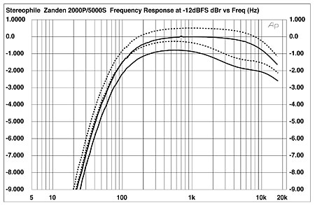

Duidelijk géén hifi spelers dus. Vooral die Zanden, wat een extreem slecht apparaat! Zit daar een uitgangstrafo uit de jaren '20 in of zo? ;D

Het grappige van het verhaal Koen, is dat van deze genoemde spelers de Zanden combie MIJ het meest bij de performance bracht.
"With the rear-panel filter switch set to Measure, the response was flat up to the top octave, which, as can be seen from the top pair of traces in fig.1, then featured a rolloff of a fraction of a dB by 20kHz. De-emphasis error was negligible, as shown by the bottom traces in this graph. With the filter set to Listen, the response above 14kHz or so rolled off more rapidly, reaching -2.5dB at 20kHz."

Tsja, het neerkwakken van een paar curves zonder verdere indicatie levert natuurlijk ook geen oplossing.  :D
Zijn dit trouwens de spullen die jij thuis hebt staan ??
Maar laten we even naar die Wadia kijken (wat ik overigens een prima/prettige speler vind en dan de juiste curve en het commentaar erbij pakken:
Fig.2 Wadia 861, external input frequency response at -12dBFS with (from top to bottom): 96kHz sampling, Filter A; 44.1kHz sampling, Filters A, C, and B (right channel dashed, 1dB/vertical div.).
"Because the review sample had a digital input board, I was able to examine its frequency response with higher sample rates than the CD's 44.1kHz. The top trace in fig.2 shows the response at a 96kHz rate (of necessity, it includes the response of the A/D converter used). It was the same regardless of the filter selected, and shows the top-of-the-passband droop characteristic of the DigiMaster algorithm. However, because of the higher sample rate, the audioband rolloff is negligible, allowing the user to have his cake and eat it too: flat audioband response and excellent time-domain performance. This graph also shows the 44.1kHz response with Filters B and C, which are both flat in the top audio octave, though differing slightly in level, as mentioned before."
Waar je kennelijk op duidt is de 1/sinc(x) response, waar voor gecompenseerd moet worden. Wel bij de intro van de CD-speler was dit inderdaad een probleem, dat de Jappen analoog trachtten op te lossen en Philips (primitief) digitaal. Het resultaat is bekend: die ouwe Jappen klonken enigszins pijnlijk aan de oren.

Nee, ik bedoel aan de onderkant... Daar bovenin hoort het ook wel recht te zijn, maar zo'n ramp lijkt het me niet als het wat afvalt. Dat laag daarentegen ga je bij sommige muziek écht wel missen:
marconist
Ja, die curve had naar mijn smaak ook wel wat steiler mogen zijn .......

Sidebar 5: Second Sample Measurements
The first sample's frequency response when set to the correct polarity was disappointing, with a noticeable rolloff of low frequencies that reached –3dB at 65Hz and –9dB at 24Hz. The second sample was flat to below 10Hz into a high 100k ohms load (fig.1, top traces below 100Hz), with only a slight bass rolloff apparent into the punishing 600 ohm load (fig.1, bottom traces). The response was identical with the DAC set to invert polarity, but the top octave still rolled off a little prematurely.

Als je de absolute fase omdraait doet 'ie ineens dit? ???
Koen, als je goed leest duid dit op een exemplarische fout, aangezien het tweede exemplaar in beide polarities een zelfde curve liet zien.
Bij die Boulder met z'n -1 dB @ 20 kHz vraag ik me wel af in hoeverre dat nou hoorbaar is ;)
Voor een stukje zelfbescherming heb ik begrip, maar dit is op zijn minst een boude uitspraak te noemen. ;D

Wat is het doel van deze toestand dan? Jij post een grafiekje van een bizar slecht presterende (blijkbaar kapotte) speler, ik reageer en jij komt met een soort "haha, gefopt" terug of zo ???
Nou, euh, ik hoop dat je er lol aan hebt beleefd ::)
Misschien voor jou niet zo'n leuk grapje, maar het ondersteunde enerzijds mijn pleidooi over de liniaal gladde respons ::), anderzijds het toch altijd wel snel afgeven op duurdere apparaten, en - zoals dit voorbeeld ook al aantoont - zeker als ze ook nog eens niet goed meten. ;)
