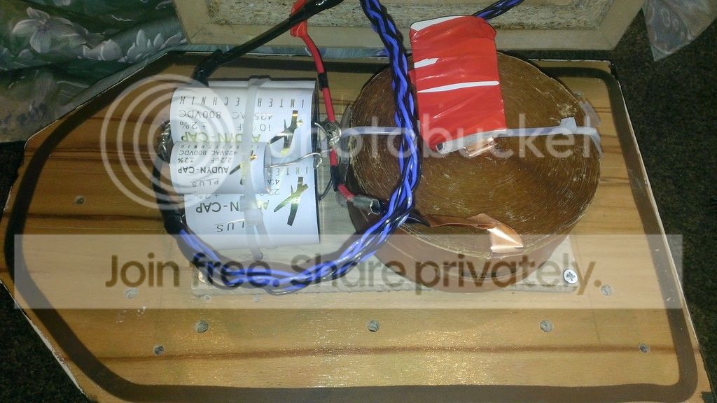

I am almost finished with my Milestones. Only cabling and attaching the drivers left.
I decided to have crossover on outside of the cabinet, by creating a pocket in the lower back of the enclosure. I increased the total depth by 30 mm, and the lowest 400 mm of the back were moved 90 mm into the enclosure. Theoretically, the internal volume is approx 1 litre smaller, but the volume of the crossover is about the same.
I followed Marc's latest crossover design, and 12 awg wax coils, which is why the crossover got rather big.

Great idea. I think I understand.
(except for the bottom of the speaker)
Do you have a picture of the rear of the cabinet ?
For the record. I removed some filling and pritex, with succes regarding the sound.
Seems you used quite a lot of pritex.
But all remains accessible, so you will always be able to remove some later...in case
torquemada
I will try to remember to take pictures of the rear. However, the top picture illustrates the "feature" fairly well.
The bottom of the picture is the bottom of the speaker - the right hand side is the back of the speaker.
I have placed the binding posts in the pocket, bottom right in the picture.
The cabling will go from the crossover into the speaker at the top of the pocket, in the middle of the picture.

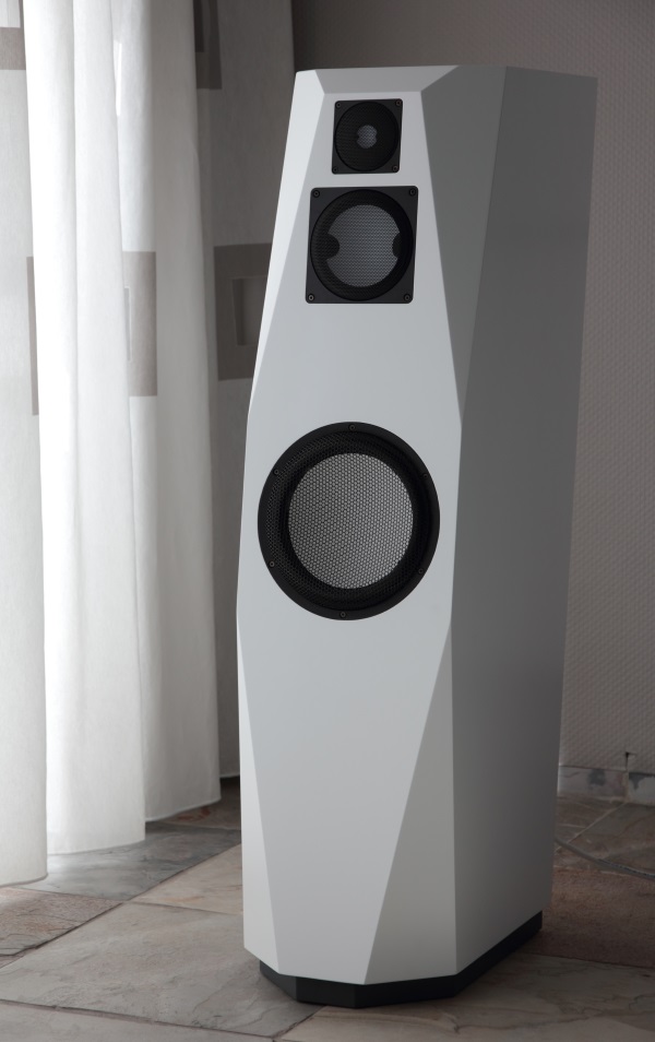

Fortunately, I have a very, very good childhood friend (Tomas Modin) who I is a carpenter with his own joinery. As a bonus, he is as interested in hifi as I is.
I use the same foot/base as in Marc's drawings. The binding posts are standard WBT which will come out/point towards the floor. Thus, spades will work, but not banana plugs.
Tomas' joinery also is equipped for spray painting. The laquer is "standard paint" that Tomas uses for MDF, half matte white. We (he) tried first with high gloss (close to piano laquer), but it didn't fill and cover enough. Possibly, we could have sprayed the final (fourth) coating with high gloss, but the half matte was good enough. Also, I have two children (4 and 6 years) whose greasy fingers would leave more visible prints on high gloss.

salautom
I love the white color! very nice!
(see image of mine...)
