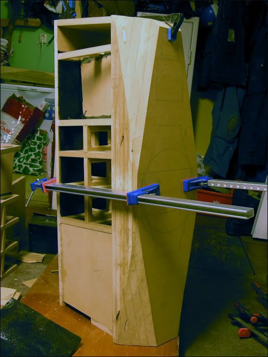

A easy and fast way to build is with "biscuits"
Internal bracing:
The front is made of 6 layer of 19mm MDF = 114mm thick. Needed for the chamfers on the sides but will also do the cabinet very solid.

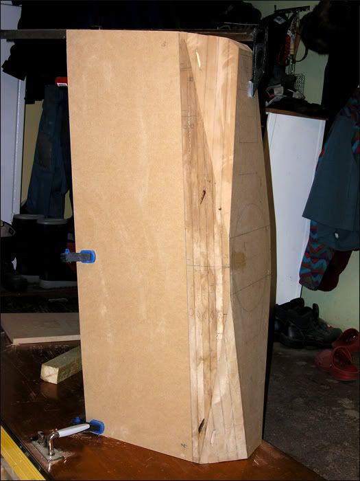

A few more of the building of these Eidolon clones:
It is a lot of work and a lot of wood
I have covered the middlerange cabinet, build as an 3 edge with bitumen.
About these speakers, i have much help from people from this forum. These are mostly speakers constructed by people here, i only may do some minor changes. I appreciate all the help.

mangew
According to my calculations is the whole internal volyme be around 85L, and excluded box for mid and internal bracing somewhere 70-75L for woofer.
mangew
mangew
#49
Internally it´s a lot of bracing, all glueing with construction glue PL400 covered with silocone and walls covered with bitumen making the cabinet extremely strong and heavy.
