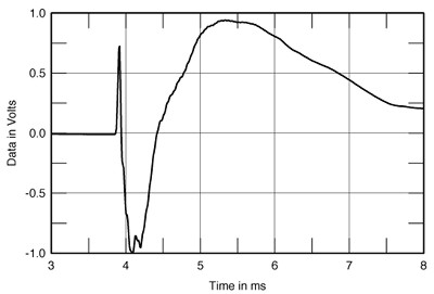

Miskien help dit met die crossover ontwerp. Uit die Stereophile review:
The acoustic crossover frequency between the midrange unit and the woofer appears to be set at around 150Hz. The inverted-dome tweeter has a small rise apparent above 15kHz, but rolls off sharply above the audioband, while the speaker's overall response in the midrange and treble is basically flat, though broken up by small peaks and dips. As these tend to be equally spaced, with peaks balanced by dips, the perceived balance will tend to be neutral.
Aiding this is the fact that dips tend to fill in and the peaks become suppressed to the speaker's sides (fig.4). In typical rooms, therefore, the Sophia will tend to sound evenly balanced in the highs. In the vertical plane (fig.5), the speaker's balance doesn't change much as long as the listener sits with his or her ears below the top of the enclosure. Stand, however, and a large suckout appears at the upper crossover frequency, which appears to be just under 2kHz.
