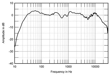

Marten Coltrane:
Frequentie respons Marten Coltrane
Maar dit stukje gewenste energie kost veel energie en:
"However, I note that even after Mikey had optimized the Coltranes' setup, he still found the speaker "a bit bright and spotlit on top, slightly lean on bottom."
