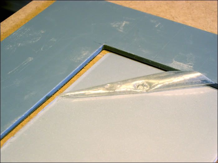

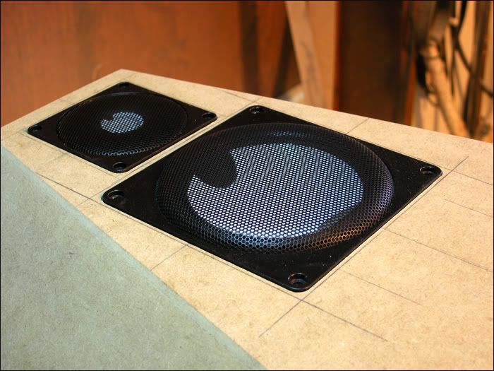

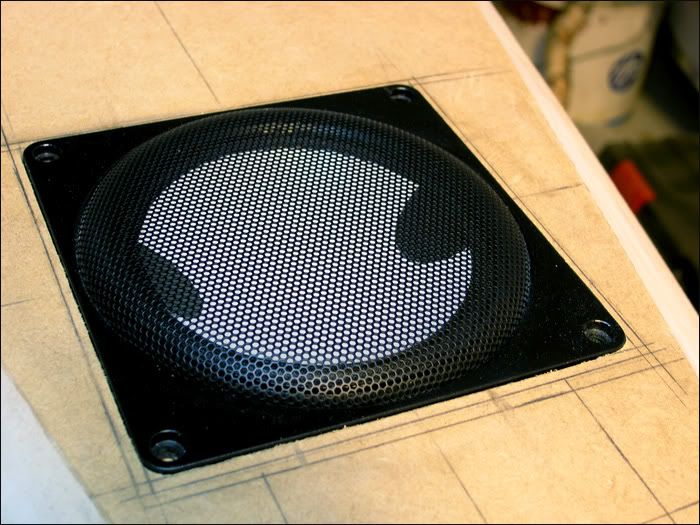

What's with the metal inlays?
Citaat van: mangew op januari  6, 2008, 22:43:44
Is it a kind of template that you used for the speakerdrivers?
Een aktief leven geeft meer voldoening dan een passief leven.
mangew
#56
The metalplate is 4mm thick aluminium, it´s for the terminal together with the binding posts shown above. The template is done by regular plastic, same way as for the drivers to sunk the plates into baffle. Avalon has the terminal under the cabinet but to make easier to change speaker cables i will put the terminal on the backside.

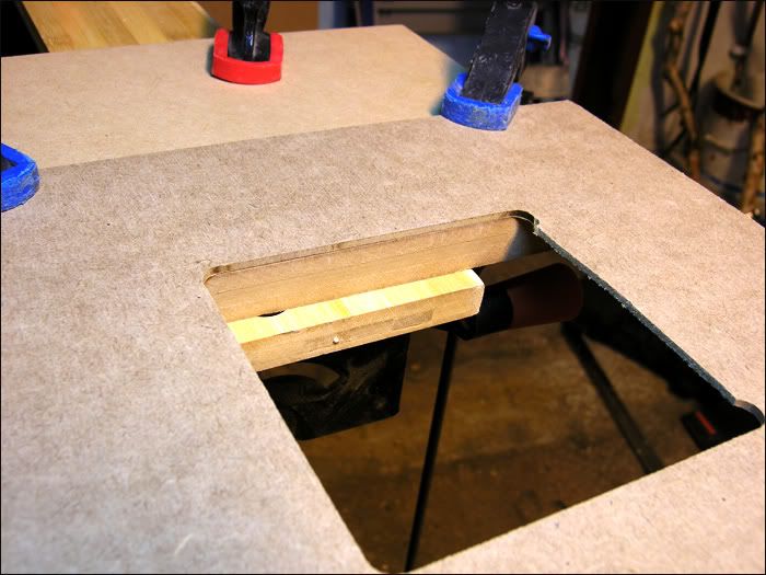

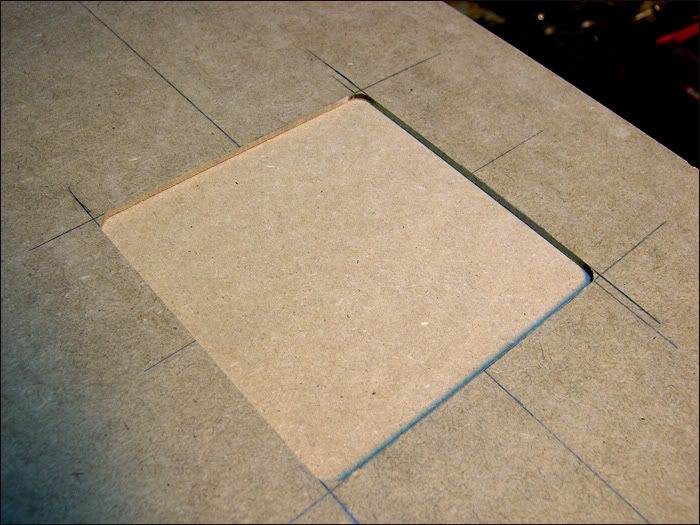

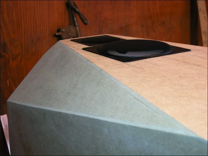

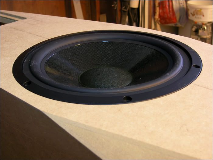

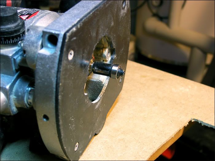

Starting router for sinking speaker units...
Making a template
Finished

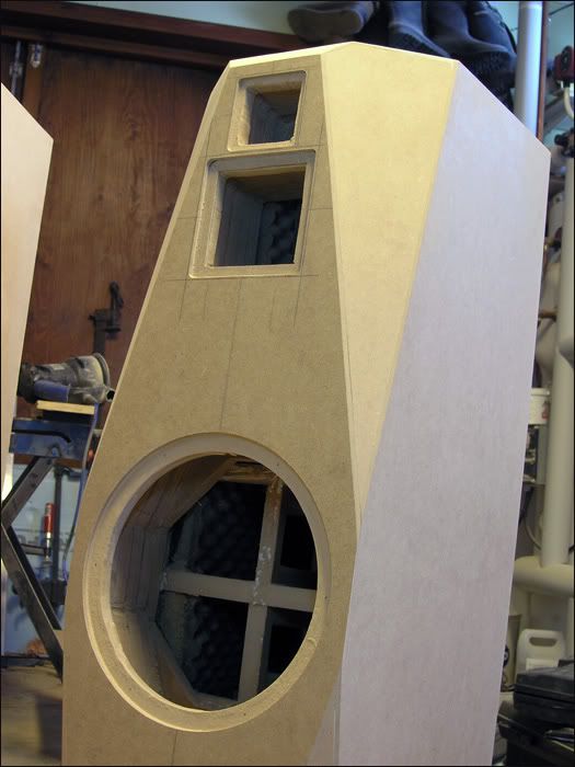

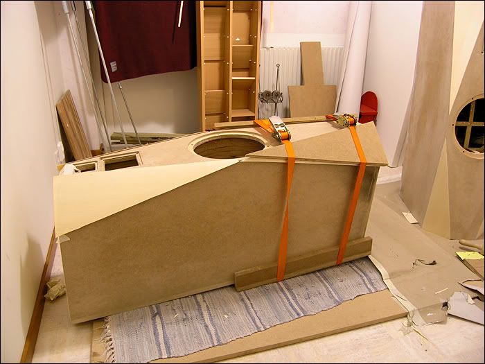

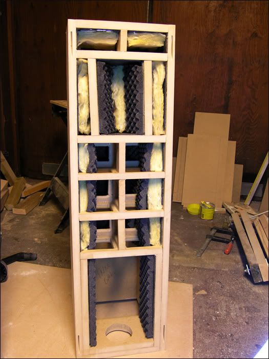

yet another Eidolon clone soon to be finished:
Internat bracing and damping:
The cabinet is cvered with 3mm MDF to cover edges and chamfers on front:
mangew
mangew
FFF
Bery nice.
But i think it's better to remove some damping materials.
The experience is that this will giva a faster and more detailled sound.
Marc Heijligers
Citaat van: FFF op februari 27, 2008, 12:28:06
Bery nice.
My experiences are the other way around. You should stuff the cabinet with wool, from top to bottom, to make sure that decays of sound sources in recordings are not masked by any cabinet resonances. I wouldn't use pritex though, only a little bit to keep the wool at its place.
Marc
Een arbeider werkt met zijn handen. Een vakman werkt met zijn handen en zijn hoofd. Een kunstenaar werkt met zijn handen, zijn hoofd en zijn hart.
Erik van Voorst (in memoriam)
I agree...I tried with and without wool... ;)
I also tried a little bit and a lot....
Wool for me ....any day of the week....and a lot.....  ;D
mangew
So, then it´s not to much could be more damping material?
The project still in progress, cabinet alsmost ready and waiting for crossover design to be finished.

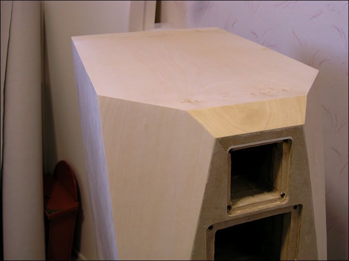

At last there is not much left to do before i can listen to these speakers.
Veneer is put on the cabinet:

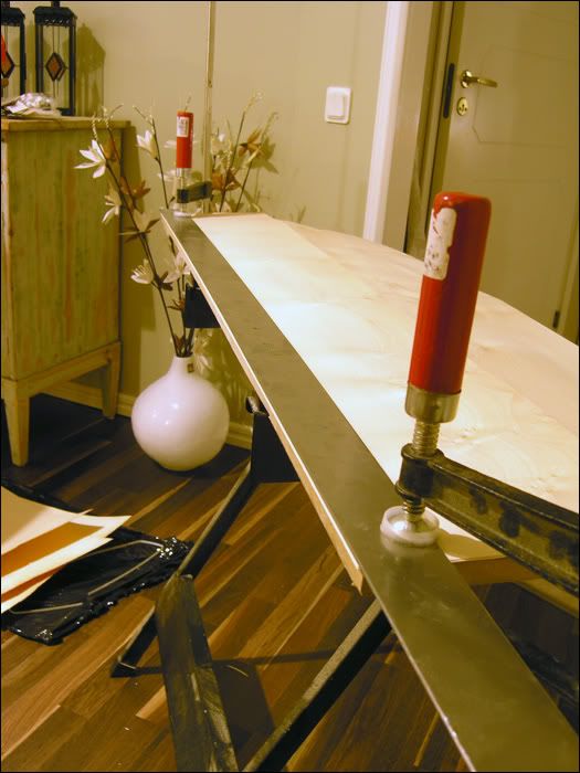

How i put veneer on the chamfers on front:
mangew
To make perfect edges to fit veneer sheets to each other:

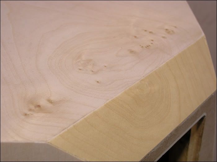

Veneer finished:

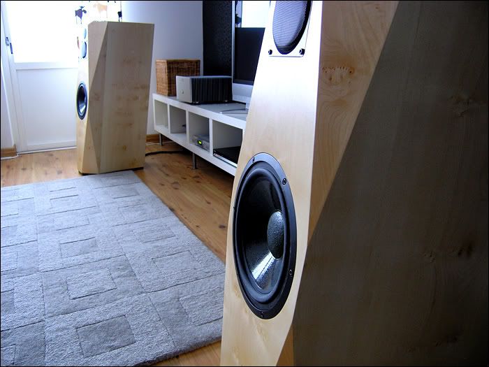

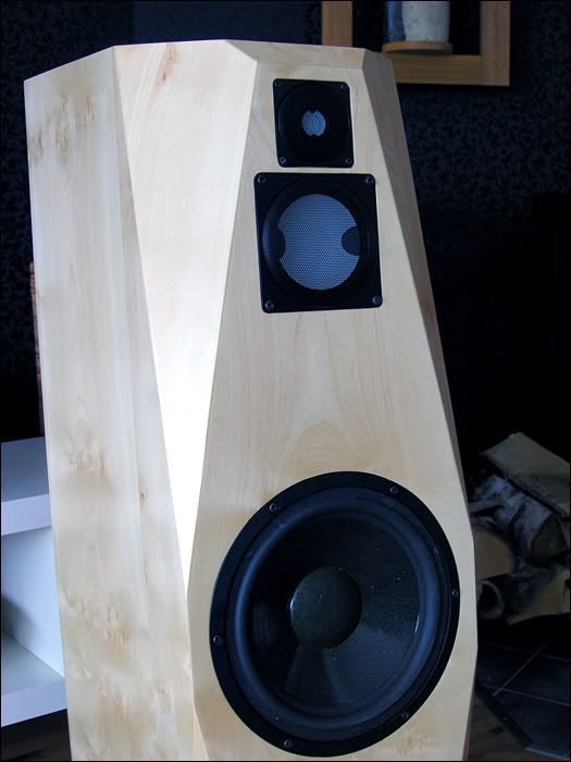

mangew
#74

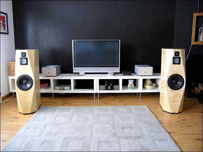

It´s been a long while since last update. But now the speakers are finished and i post the result of the long thread(in time). Thanks to this and another (zelbouwaudio) forum i have build these speakers and had good help from members here. Haven´t listen so much but they sure sounds great so far
